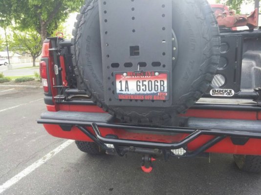

For now the N-Fab rear runner accompanies the TireGate pretty well in my opinion, so for a while that's how it'll stay. In the future I'm planning on having Fusion build a rear, only it will have a fairlead slot where the license plate is. License plate is already relocated to the Smittybilt I Rack. I'll put a matching 12k Engo synthetic winch where the spare tire is supposed to go and have a rear winch setup. I'm also going to have Fusion incorporate steps in the ends of the bumper like the Premium line from FabFours.
This will happen in the far future as I have other projects I want to focus on with the truck, like bumping to 7" lift, 37" Trepadors, and trussing my axles.

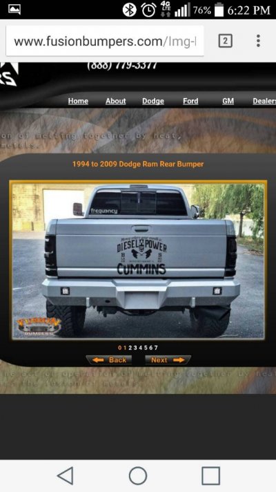

I called around to several companies, including Fusion, regarding getting a custom rear bumper built, and I've finally found a somewhat local company to build it for me.
Come February I'm dropping the truck off in Spokane, Washington, to have FlyFab build my new rear bumper. They offered to build it, including my ideas and designs, for $1300 compared to next best price of $1800 from Fusion and it not including everything I wanted.
