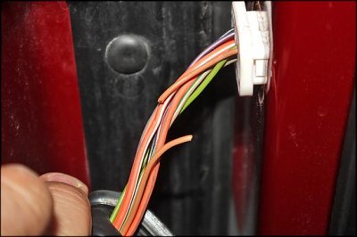

Here is the wire. Just broke apart. Have to remove the boot to see.
As soon as I get a chance I'll pull the boot back and see if it's a problem. Kinda seems unrelated cause right after the lightning is when my problem occurred. But you never know until ya check!
