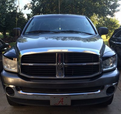

Head Light modification
I found myself tired of buffing out the top lens of my headlights due to oxidation and the sun. I saw online where someone purchased some match painted lens covers that made the dodge look angry, so I figured I could do that. If i screwed up I would just purchase some new headlights anyways and call it a learning experience. So I grabbed some electrical tape and my painter's tape and started cutting 1mil thick liner into pieces to cover for over-spray, I did not want to remove my lights, just lazy I guess.
The electrical tape allowed me to match each side fairly easy.
After 4 coat of Black Krylon and 3 clear coats, it was finished.
I used black only because the gray was very difficult to match and black was the same color as my molding pieces anyways. Not bad for an hours work.
