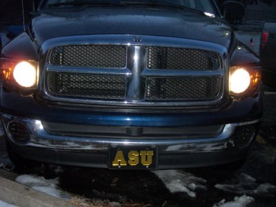

well i finished one(driver side). my wife had to go to work and took off with my tools in the durango so i couldnt do the passenger side today. i will get to it tomorrow. after 4 1/2 hrs, 2 coats of primer, 4 coats of base color, 2 coats of clear coat this was the finished product. let me know what y'all think

looks great!

thanks. i finally got both of them done. and im very happy with the way they turned out. thank you very much for the help and advise, jeremy and matt

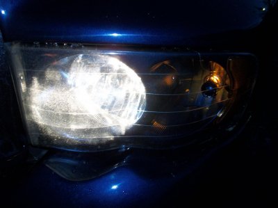

heres pics of the final product

very nice!!!

thanks alot y'all. without peoples advise and guidance on here i wouldnt have known how to do it, so thank you for your help.
