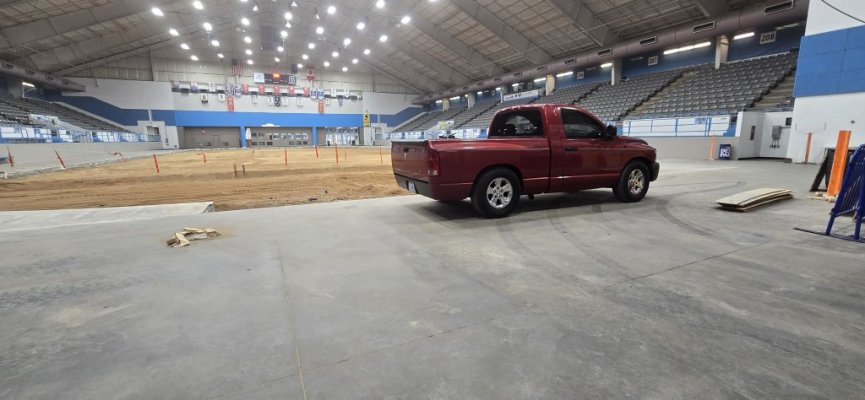

All of the above. I own several
Buy a wrecked parts truck of the same year and get to swapping everything. I'm not sure what was compatible from the v6 to v8 truck. So I just swapped everything down to the last wire. Had a driveshaft cut for it and changed all the fluids. Made a custom exhaust just till I get to a muffler shop to have some made. I used the entire dash, heater box, rear end, headlights (06 parts truck had different headlights than 07), added the overhead display from the parts truck. Taillights also had to be changed. Due to the 1 year difference. There was absolutely no cutting or welding besides the exhaust. Then engine mounts and transmission mounts all line up. The truck in the pic was a base model with no cruise, hand crank windows, minimal gauges. It now has all the features from a Laramie truck.
