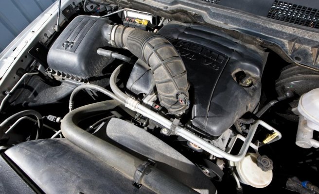

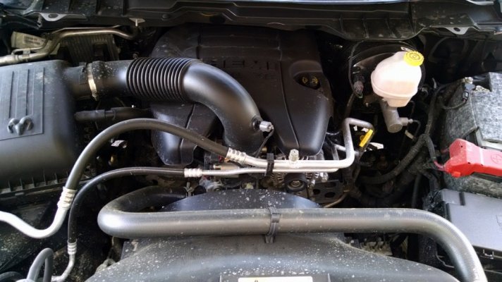

I got a stock air intake system for $20 from a '13+ RAM. I noticed that when compared to my '11, the air intake tubes look very different. I really like the color and look of the newer intake tube, and want to install it. This is less about performance and more about aesthetics. When I was installing it, I noticed the air intake sensor was different or at least the mounting hole is. What sensor do I need to replace mine with, or is there another way to make this work? Looks like there may be a different harness plug too? Is it too much work/effort? Pics below of what my engine bay looks like versus the newer ones.
Old:
New:
