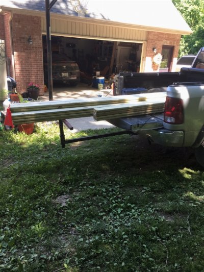

Had to pick up some 12’ decking boards after work the other day. I really didn’t want to take my trailer(where I work, it’s a pain to park with a trailer). So, I hit up my scrap pile, plugged in the welder, and ended up with this.
All made of 2” X 2”X 1/4” wall square tubing.
It’s 10’ from the front of the bed, to the support.
Worked really well, and I have a few ideas in the works to potentially turn this into a “multi-use” item.
Oh, almost forgot, truck is a crew cab, short bed(5’-7”), 1500 4x4.

REALLY nice idea....you can even put some "pitch" on it to make sure the material wont slide out of the bed.
I have the 6-4 bed and would love something like this for myself....alas, I dont know how to weld :)

It’s hard to tell from the pic, but the support is slightly higher than the bed floor. This helps keep some weight off of the tailgate, and helps keep the boards from sliding. Also, the cross bar has holes in the end, so the load can be secured with a ratchet strap.

You are correct, there are several companies that make “hitch mount truck bed extenders”. Most seem to be in the $60 to $100 price range.
I just couldn’t justify purchasing one(and having to wait for it to be delivered), when I could build one in under an hour, with materials I had laying around.

On the horizontal bar (where the wood is resting) the ends are open and there are holes there. Any thoughts on adding uprights so there's no lateral shifting?
They could adjustable, for narrow or wider loads.

I have been thinking about adding uprights, just haven’t gotten to it. For the time being though, opposing straps attached to the ends of the horizontal bar, seem to work fine.
