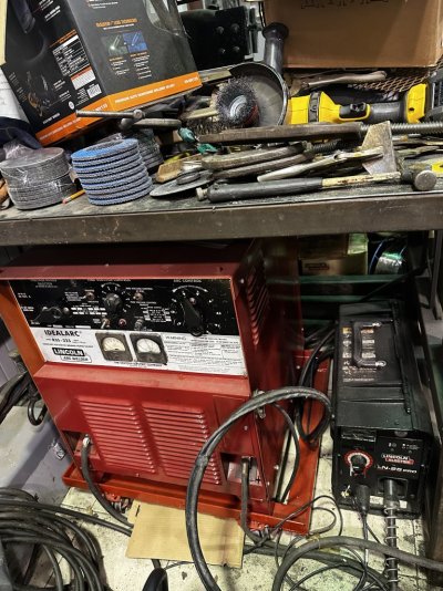

Picked this up last year off craigslist. Short on projects and scrap steel last summer and fall. I gots lots and lots of steel this year. A great welder for $300 with ~40' leads.

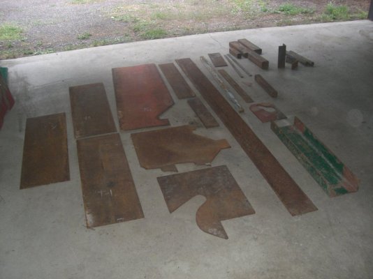

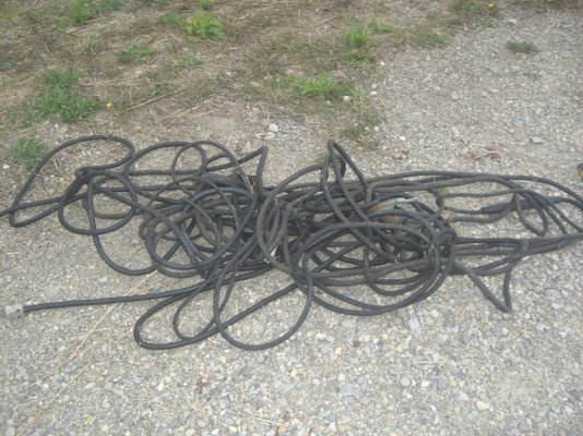

Helped a neighbor widow clean up her late husband's junk. Lots and lots of steel. Easily $1000s worth. Another big find on 2/0 AWG leads with LC40 terminals that matched what was on the welder. All total I've 70 to 80 feet of leads for both stinger and ground. Below is a small example of what I was able to haul away. The rest of the pile of junk, mostly steel and some aluminum was hauled away by scrappers. With my help filled 3 pickup loads and two utility trailers worth of scrap, probably several 1000s pounds easily.

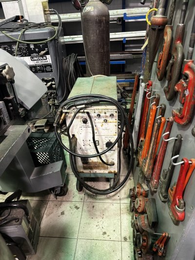

I just have these. Plus this grinder if the weld is too ugly.
Looks like quite the shop with the walls lined with metals. That Lincoln 300/300 must be a beast. 3-Phase?

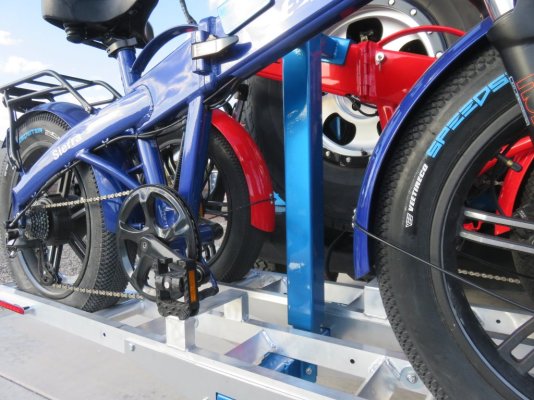

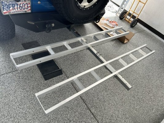

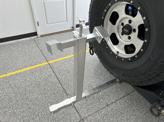

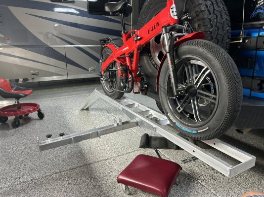

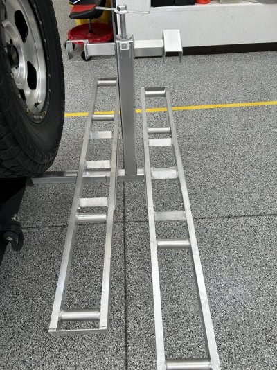

Anyway, here's one of my latest "little" projects. The wife and I have a couple of folding E-bikes and we often take them on our RV trips along with the Jeep etc. We needed a bike rack to haul these two 70 lb. machines. After scouring ads and Youtube vids for quite some time, I'd determined that just about any and all bicycle and so-called "E-bike" racks were JUNK! To me, there's waaaay too much slop, wiggle and wobble and not a lot of structural integrity.
Soooo, I decided to purchase a dual motorcycle rack from Vevor and then just modify it. It's a long, long story but here's the real short version. It's a steel back bone rack with aluminum trays for the bikes. Each tray was too long for the E-bikes so, I shortened each one. The distance between the trays was too wide (due to it being designed for two motorcycles) so, I cut the back bone down and removed and reinstalled each tray mounting bracket to decrease the distance between the trays.
There was inverted V-shaped angles in the trays for tire contact and were placed (welded) in the wrong spacing for our e-bikes. Soooo, I cut those out and tossed them in favor of some 1 1/2" round 6061 T-6 1/8" wall aluminum tubing. I TIG'd those in the proper spacing for our 20" tire/wheels on the bikes. The trays were reinstalled onto the back bone and that took care of that. Now, since I'm not in favor of 20,00000 tie downs (almost exaggerating there some) or any other factory type securing mechanism, I designed my own.
Basically, it's a "clamp" type system with one, single clamp that locks those bikes from moving in ANY direction, sideways, laterally, and up and down. I designed and fabricated a lock system for when the bikes are left unattended while we're in the traveling mode. Ok, enough blabbing. Take a look and see what you think.

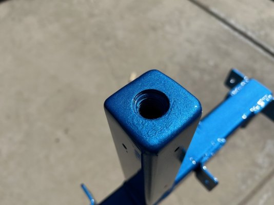

Here's a couple more pics.
By the way, as you can see in some of the earlier pics, I had originally painted it silver simply because the aluminum parts were silver or aluminum colored and I thought I'd match. But, the silver paint was junk out of a rattle can so, since I'd had specially made some paint to paint my '20 Honda NC750X DCT to match our Jeep, I had some paint left over so, why not. It's now Hydro Blue Pearlcoat (as Jeep calls it).

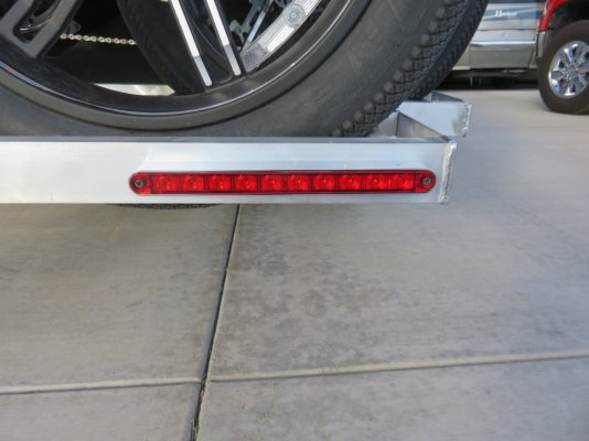

Nice
Where did you get those LED lights?
Also how long are they?

Very nice! I do enjoy welding. What you accomplished is beyond my skill set, and is not just that I can't weld aluminum, nor do I have the equipement to do Tig.

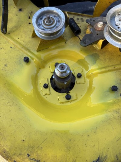

My best freebee saved this guy a grand easily and he helped which was very appreciated ->

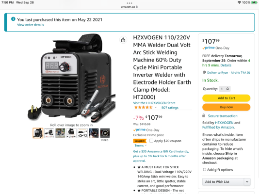

This was my craigslist find, a very nice inverter flux core welder. Barely used ->

A good friend of mine turned me on to those LED stop/turn/tail lights. I'm usually pretty good at locating things like those but, for the life of me, I couldn't find those particular ones. So, I called my buddy and he picked me up a set and they were around $21 for the pair. I used to have the brand and part numbers stored some place and I'll have to dig around and see what I can find out. As for length, they're around 12" or so and about 3/4" high. Not a very big light to say the least but, when in operation, they're actually quite bright in all phases, running, turn and brake.
The red one is 3ph the gray one is single. I designed and built the shop. Auto, machine and welding on one side and wood on the other and supplies and old radios up in the mezzanine. 7700 square feet. Insulated panels metal on both sides.

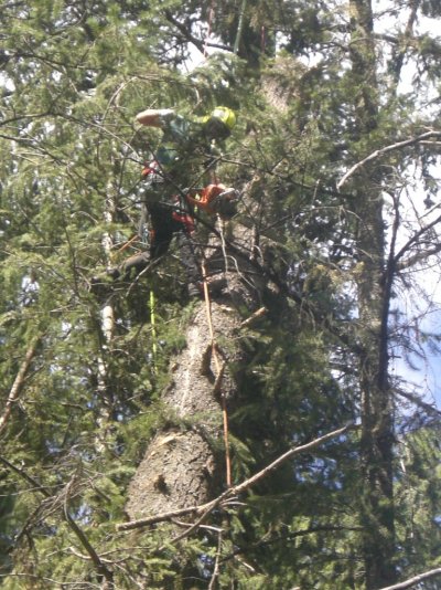

My welding success was front and center a few days ago. I'm going back and forth cleaning up storm damage on my neighbors properties. Lots and lots of down BIG trees. One is easily a 300yo tree and I cut into 16" sections for my firewood use. One piece is a mess with big burls on it and when I tried to slim it down I hit metal. I hate that.
Solution, keep it as it, but it is massive and I cannot get it to budge more then a few inches. Neighbor came down and with chains and with his loader bucket the tractor couldn't move it either.
Success? Years ago I welding some front hooks on the bucket and I'm pretty sure this was their first use. Kubota engine at full throttle, attempting to lift, surely something had to give. Not the hooks they are on there for good. Nice to see something welded exceed the intended purpose.
Another property Pics ->
