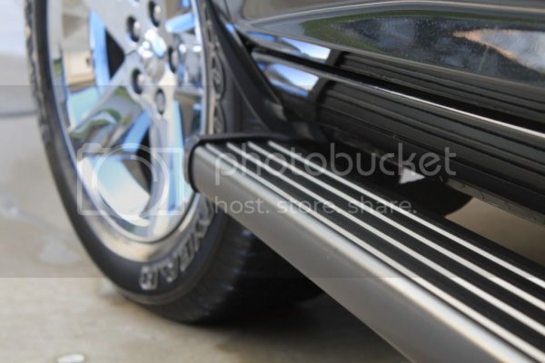

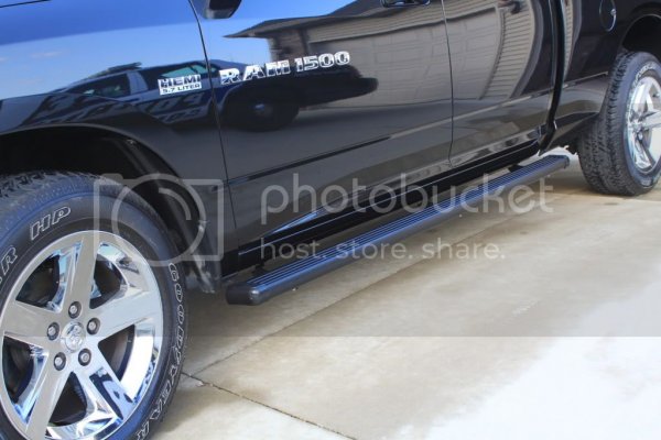

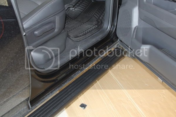

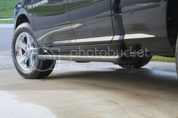

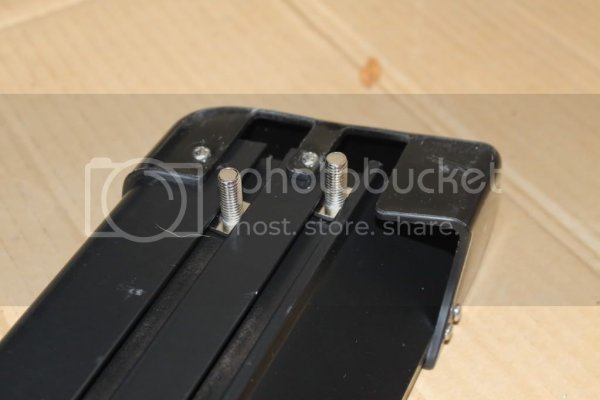

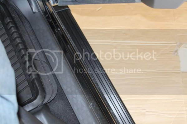

So I purchased some side steps for my 2011 Quadcab. Bought them on Ebay from TruckGearDirect. They call them Hunter 4x4 steps out of Texas but China was on the box upon arrival..?..? So $139 shipped in 3 business days. Alluminum and “powder coated” which I think is more of a thick black low gloss paint….but looks good. Plastic end caps to keep out dirt and custom fit brackets so no drilling was required. They come in polished too for a few bucks more. Overall I give the installation a 8/10, quality a 7/10, price-to-value a 7/10. FORGIVE THE MESSY DIRT AND GARAGE:i_rolleyes:

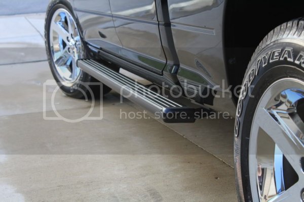

What the Ad picture looks like (as of 10-31-2011):

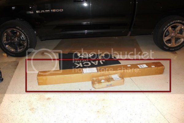

What you receive:
What you need to install:
What is inside boxes:

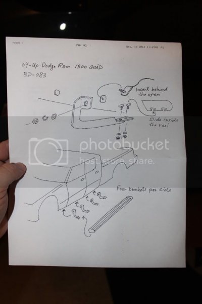

Directions
(They say to use 4 brackets per side, but I only found 3 areas and 3 seems enough):

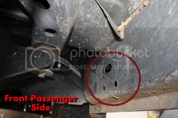

Remove tape in 3 spots per side:
Insert welded bracket:
Install Brackets:
Install (2) bolts per bracket:
Tighten all bolts and then give them a good stepping on and then re-tighten.

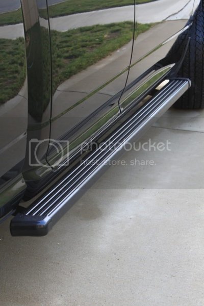

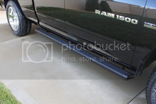

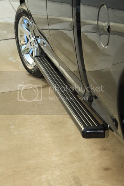

Finally got around to washing Rambo today and snapped a few new pics:

not bad!
SMITHY
Oct 24, 2011
501
KANSAS CITY
2011 Dodge Ram Quad 4x4
4.7 Magnum
They look good! Great price.

not bad. they should have used the other 2 holes where they mount to like the OEMs have.

Man do these side steps look great on your Ram. Could you tell me what is the length of your side steps? I have a Crew cab, and they don't sell these side steps for my cab style. So maybe I can buy your size of steps and center them, (a little less up front and back towards rear doors), so to fit on my cab. THX
Welcome to RF, Go to the introduction section and introduce yourself and post pics of your truck. We love pics. You can find link in my sig to the introduction section.
From the way these mount they look like they could possibly work for you as long as the rear mounting holes are not too far back

Do all 4 gen step bars use just the body mounts?? Both my 3rd gen trucks had steps that used the body/frame mounts. I'd be a little worried about the long term durability of the steps using only the body..
