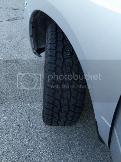

I was thinking Toyo AT2s also. Stock size is a 275/60/20, and tire rack has a 275/65/20. Do you have a pic of what the truck looks like with them on? How do you like them?
develand
Aug 25, 2015
1,375
633
Here are the AT2. I love them and they have been great so far.
I looked at a few different sets, and the warranty and positive reviews is what made me go with them.
Side photo doesn't really do the tires any justice, but in person you can see the side tread better.
