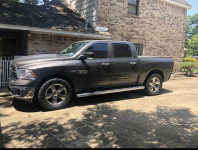

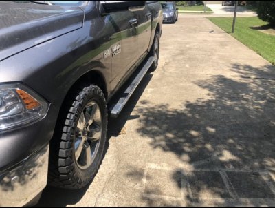

I have 285/60/20 Nitto Ridge Grappler on my stock wheels on a 2wd lone star. No rubbing no issues.
