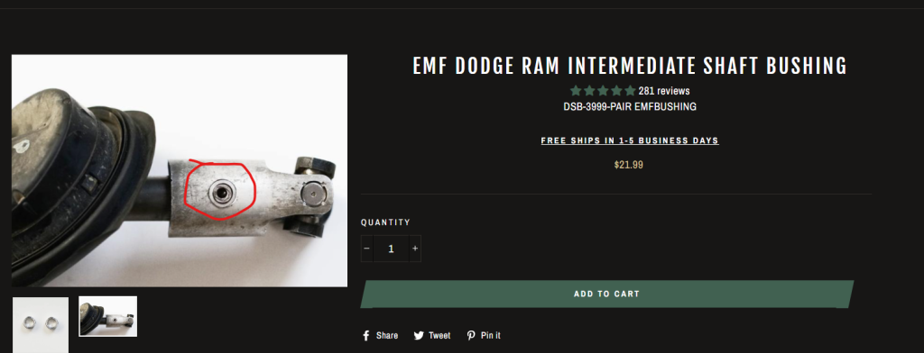

I had something similar on my 2012, and it ended up being a pin through the steering shaft in the column that had a lot of play around it. I made a bushing and pressed in to take up the slack. Steering wheel "rattle" was gone after that. May not be the same thing, but might be worth looking into. Apparently they're now for sale.
I’m sure mine could use this.

It caused quite the rattle/clunkiness in my steering column, that's for sure. Even my 2018 does it now, but I haven't bothered to fool with it since I know what it is and haven't had the time.
