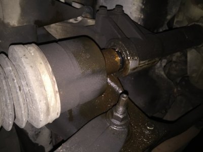

Front diff seal leaks on passenger side but only a image.jpgsmall puddle. Could it be the inner seal or the outer seal? I've read the outer one is just a dust gasket so does that mean the inner one is also busted?

Front diff seal leaks on passenger side but only a View attachment 76359small puddle. Could it be the inner seal or the outer seal? I've read the outer one is just a dust gasket so does that mean the inner one is also busted?
Dude come on, dont hijack threads.
