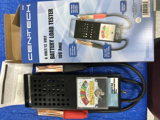

Have you checked the voltage or condition of the new battery. If it’s down then possibly a problem with the eTorque 48 volt battery pack. It charges the 12 volt battery.
These testers are great for testing the starting power of your battery and cheap at Harbor Freight.
