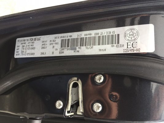

Now take the stickers on my truck, first the door jamb. Same basic numbers as above.

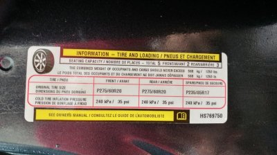

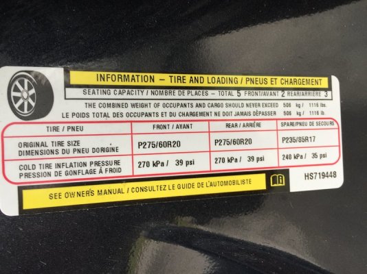

The the nasty tire sticker (because FCA put Passenger tires on a Truck):
Max load: 1116 lbs ... no where near the 1450 they claimed. No big deal, can upgrade tires... but can you get a new sticker for the new tires? Hmmm...

GVWR: 6900 lbs
Weight of truck empty but with full fuel: 5880 lbs
6900 - 5880 = 1020 lbs
This leaves us with 1020 lbs of "legal" payload. My god my Jeep Rubicon Unlimited has more payload than this (but sure as hell isn't listed as being cable to tow 9000+ pounds, it's rated for 3500).

What tires do you have?

BTW the 20" wheel factory Wranglers are rated to 2,601 each or 10,004 for your truck. The 1,116 is due to GVWR and actual weight as it left the mfg. That said moving from a standard load tire to a better load rating tire will add some stability.

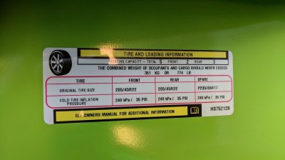

lol...my jamb sticker says 774 lbs of cargo, yet I have CC/SB 8 speed with 3.92's and is rated to tow 10,340 lbs with a GVWR of 6200 lbs. I had it CAT scaled at 5910, full tank and no people or cargo in it. So, what, that leaves me with 390 lbs of cargo capacity? LOLOL. I'm 180 and my wife is 150, which leaves me with 60 lbs of cargo capacity?
If I put 4 adults in the truck I'm over weight. Legally, I can't even tow my boat with this truck, if I go by the stickers.
I just go by GAWR and don't exceed those numbers. 3900 lbs per axle gets you 7800 lbs of GVWR. So, my truck being 5910 gives me about 1800 lbs of cargo capacity, which is more realistic for the config of my truck.

For your hilarious viewing pleasure. And, I did ask the dealer about that and even they said the manufacturer must have left a "1" off the front of that number. There's no way in hell it only has 774 lbs of cargo capacity. LOL
