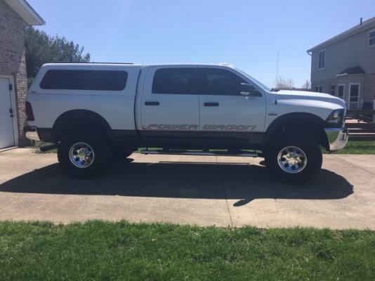

Here are some pics of the tires I just mounted. This is a 2016 PW with 1.5" Thuren front springs and a 1" spring spacer in the rear. Tires are 37x13.50R17 Ridge Grapplers on 17x9 ProComps with basically zero offset.
This setup would rub pretty hard on the back of the fenderliner when turning when just sitting still. Did the trimming as it's shown in several YouTube videos. This includes the lip at the bottom of the factory flare, the "hump" in the plastic liner, and then folding the pinch weld over.

Very nice, I like that you lifted as little as possible to fit those meats.. I put 35's on my 2014 Ram 2500 and had to do the same trimming as you with no lift. Do you still have 4.10's and how do you like the drive with the bigger tires and stock gears if that's what you still have?

I had 35" Falken MT's on stock rims previously. Did about a 2 hour round trip yesterday which included towns, 2 lane county roads, and the freeway at 75 mph. Didn't notice any obvious difference in power or handling.
These tires seem huge compared to the previous 35's
