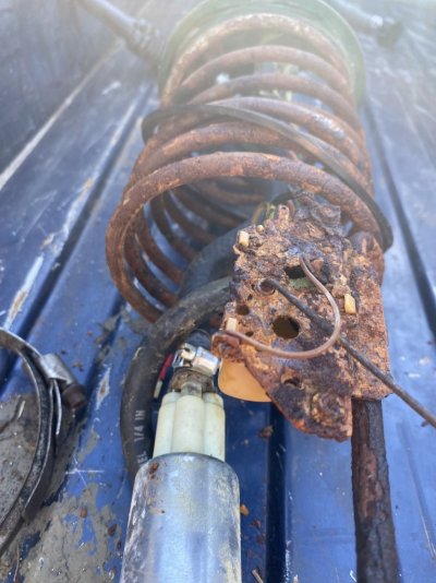

So I’m new to this game, not by choice, really. My late husband was straight up mopar man and left his project unfinished. I have been learning a lot, including how much he already taught me, which is more than I thought when he passed. I’m wanting to finish what he started but definitely need lots of help. ATM I’m having issues with the fuel pump and housing. When I removed it from the tank the thing was completely falling apart. The closest one to it that I can find is a 91-93. But can’t find a fuel tank for a 91-93. I’ve read on here before that someone tried to retro fit it into the 90 tank but eventually had to get the right year tank. I also have a 440 that needs built to put in it and thought that maybe, if that’s the direction I’m going anyway, woukdnt it be better to go with an after market tank and external pump. And if so, what are your suggestions and experiences on what I should do there?

Is the actual sender messed up? The pump itself can be replaced separate from the sender. I went through this on my '90 ramcharger.
Try private ads for trucks being parted out. For 91-93,p many trucks were magnums or diesel, which have different sending units (no pump on diesel; and magnum higher pressure), so watch for that detail.

Oh! Good to know. Yes the sender is messed up. The whole thing was completely falling apart unfortunately.

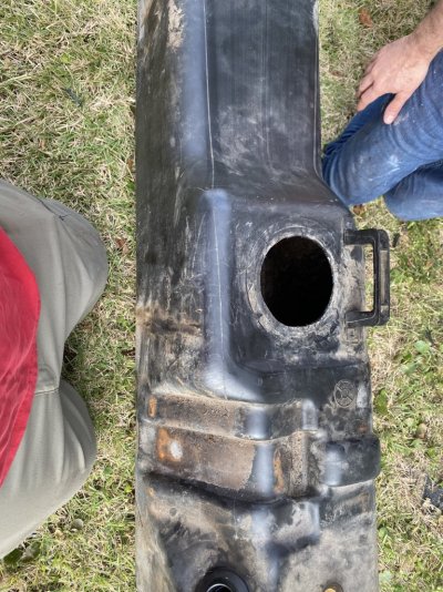

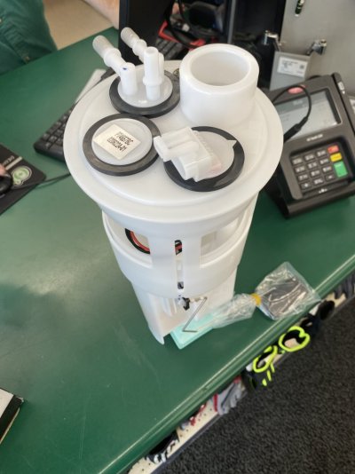

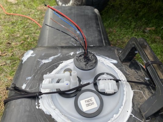

Similar… 1990 power wagon. Custom fit the 91 pump in the 90 tank. Cut a little, check fit. Probably 40 times. Then goop the **** out of it. No leaks after a year
