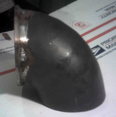

Elbow flange has been cut out.

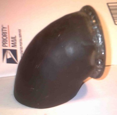

Flange is tacked to the elbow in this pic. I ran out of carbon dioxide for my MIG welder....otherwise I would have welded the flange all the way around. BTW, I'm at a perfect 90 degrees now. Tomorrow I'll run to McCall and pick up another 5 lbs of dry ice so I can finish all my welding on the stack.
For those of you that use a MIG welder with carbon dioxide, you can substitute dry ice instead of taking your bottle to Norco or Airgas. I do the dry ice method because the closest Airgas or Norco shop is 140 miles away. 10 lbs of dry ice will give you 700-800 lbs bottle pressure, and costs $15.

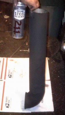

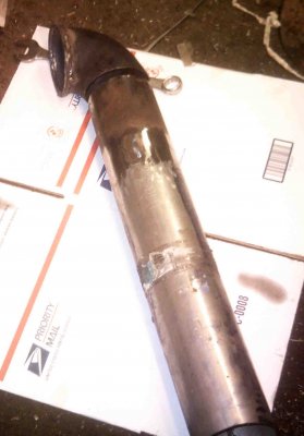

I just finished welding up the flange to the elbow, and I had to add a piece of pipe to the leftover pipe I purchased from NAPA. If it weren't for the rust on the additional pipe, you would not be able to tell I welded another piece to the leftover pipe.

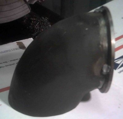

The elbow and pipe have been welded together, welds cleaned up, and painted in this pic.

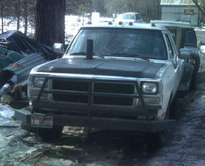

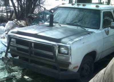

Well, here it is installed. I'll need to make a flapper for it to keep out the rain and snow :).

looks good! might be a stupid question, but does that whole in the hood allow you to open the it all the way?

I got to post up that I've seen this in action now... Hell yeah Relentless truck looks rather cool with a cloud of black rolling over the roof!
Relentless70
Relentless70
Feb 28, 2012
31
1992
5.9 Cummins
I appreciate the kudos Mike :). I saw ya coming from the other direction, and figured why not drop the hammer a bit. Was in 5th gear, just goosed it a couple times. A buddy of mine that lives in New Meadows got the same show lmao. Went to his house today, and he was truly impressed. I had to twist my brother's arm to drive the truck to town last night(sarcasm). Never thought a 38 yr old guy could giggle like a schoolgirl LOL!
This hood stack not only looks decent, but my EGTs are about 50-75 degrees cooler, and it spools like crazy. I backed off the wastegate 2 turns over the last couple days, 'cause it would peg my 30 PSI gauge in almost nothing flat, even in 5th gear. I think I need to invest in either new head bolts or studs . Bummer.
Got home from my buddys place in New Meadows, and found a crack developing in the elbow of the hood stack. Took the pipe off, re-welded it....no grinding the weld this time. Installed the pipe, and added a cheesy 1/8" thick x
1" wide brace that bolts to the exhaust manifold and is hose-clamped to the stack. I'll come up with something prettier in the near future.
I backed off the starwheel 2 turns tonight, 'cause she blows a bit more smoke than I'd like. Had to do a bit of cleanup on my fuel pin too....there was a groove that wearing into the fuel pin. I backed off the wastegate another 1/2 turn also. I'll be running the truck tomorrow, and I'll let you guys know how it goes .
