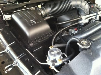

Installed my catch can this morning, took about 20 minutes. Came with instructions that were crystal clear with a little common sense. 200 miles on the odo.
