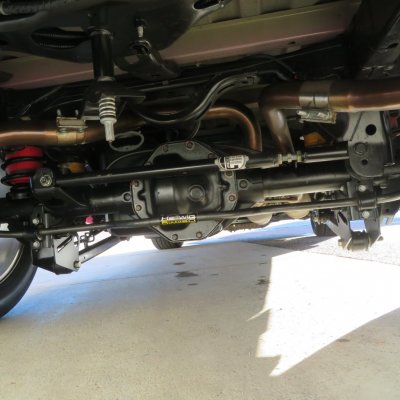

Don't buy the "no cut" brackets,even though they say they're good to 4".The majority of guys who buy the no cuts end up swapping them out for the "cut" versions.The no cuts cause clearance issues . If you decide to go for the adjustable track /panhard bar and for go the relocation bracket,you can re drill the holes it mounts to so that it runs parrellel with the ground after lowering. I redrilled both ends,but you can get away with redrilling just the frame mount,and slighty notching the bracket for clearance.If you look close at my frame mount,you can see where i redrilled the mounting hole up from the stock original hole.You want the bar as close to parrellal with the ground as you can get it.I'm also running the earlier Illicit relocation brackets

Are you getting any binding issues on the panhard bar on the rearend mount? Looks really close to the bracket and as the rear end moves upward.
It's hard to see,but the rearend bracket is also notched for clearance.****** pic,and this was when i was checking it for clearance,right after this i die grinded the notch,so it was alot cleaner,but at the time of the pic,i was still slicing it with a grinder and cut-off disc.
