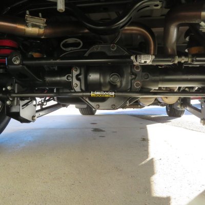

Ideally you want the trackbar running parrallel with the diff,if it runs on an angle,it'll pull the diff sideways when you hit a bump and the suspension compresses.I've probably already showed you how i redrilled the brackets mounting holes,but i forget,so here's the pic again ;)
I don't have the same setup on that frame as you. There is a large part that hangs down and the frame side of the panhard is mounted to the bottom of it. Unless I cut it off, it prevents me from putting anything on that frame side. The way it is built also doesn't really allow for drilling of any other holes. The adjustable will eliminate the need for the axle bracket and still keep the bar parallel. I double checked with a local mechanic and the manufacturer of the adjustable. There is so much tension and such on that bracket that it even broke a weld that I had someone attempt. Although he is new to welding.
Yes you do,there's no differance between your 10 and my 14,as far as how the panhard bar is bolted to the frame and diff. Look closer :waytogo: Unless you found an adjustable trackbar with an offset,it won't run parrallel with the diff
You might have to notch the frame bracket to allow you to move the bar up an inch or so,but it's nothing a few minutes with a grinder won't cure,you need an extended 9/16" drill bit to drill through both sides of the frame bracket,but they're easy to come by
I'm an idiot, it does look the same. You've cleaned yours up and it looks prettier. It looks like you have an adjustable bar though? Either way, I'm going to have a local shop do some major work here soon. My health isn't up to doing it. I'll have them fix the bar since they'll be replacing the diff with a LSD.
Take those pics with you,so they can see what you mean,if you want them to redrill the hole higher so the bar runs parrallel with the diff.Good chance they'll have to notch the frame bracket a bit,but it's nothing a decent shop can't handle
Yup i have a double adjustable trackbar,you just loosen the jam nuts,and spin the center nut to lengthen or shorten it.
My buddy used to make them,and it's industrial sized,as he used to build suspension components for the hi-po diesal guys ;) I's made out of 0.250" wall DOM tubing and probably weighes about 30 lbs or more:Big Laugh:
