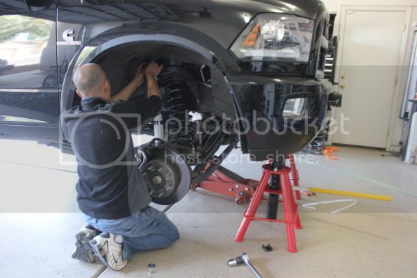

I am glad I have a garage. Was raining a bit the day I did mine.

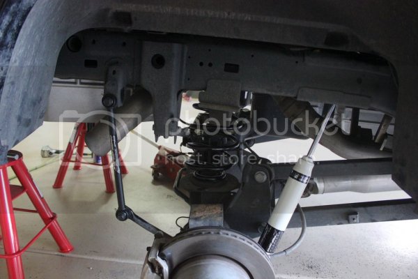

Awesome! I'm going to install tomorrow morning since I need to rent a torque wrench that goes to 200 for the track bar. Mine only goes to 160 lol. I'll be sure to post lots of pictures as I go!
Did the trackbar come set or did you have to measure it to add a bit for the spring?
I didn't do the trackbar on mine.
I will do that when I get my rear done however.

Also, working on these truck so much, I am going to buy these!!

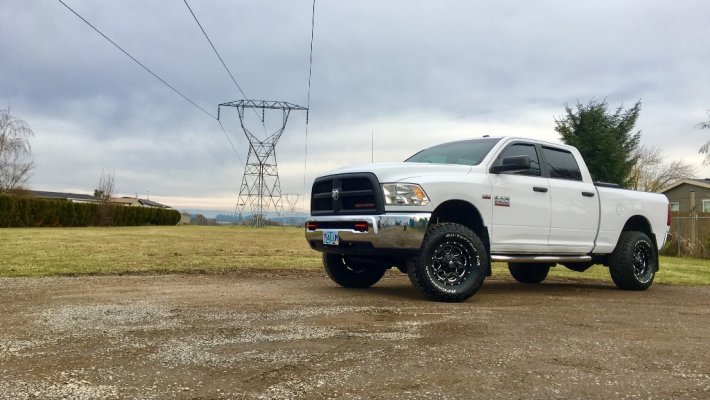

Looking for advice on the Thuren stuff. Been lurking on multiple forums reading everything I can. Have asked Aaron's opinion(at Thuren) multiple times. I have a 2016 2500 Hemi mega cab 4 x 4. Just put on 18" methods and 35's with Toyo RT's. Cannot decide between the 2" kit for the front only or the 3" kit in front and 1" rear. I think once I feel the fronts I'd want the rears as well. I do tow a boat that is 5000lbs. But not often and the tongue weight should be at 500, so not too sure about sagging in the rear. Any advice appreciated.
No regrets with the 2". Only downside is softer rear suspension. I don't mind the stiffer rear. be029955b86a20279d5b2780af5acb9e.jpg

With just 2" coils I have 1/4" of rake. f9d03cf40f80fde4e8206a44397705a4.jpg2acbe2896c6837d2b1785f66907d1ffe.jpg

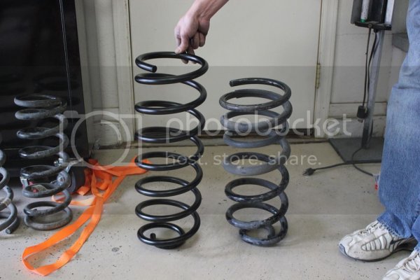

The front and rear kit is amazing. I actually was amazing on how much the truck is with a 1" coil in the rear. It comes across as a 3" lift all around. It just makes the truck appear so much taller. Even driving down the road and it's coming at you, you can tell it's been lifted rather than leveled.
As far as the ride, it's so much smoother. No bucking over bumps. The faster you go, the smoother the ride. Highway driving is where you feel it. It's like a car.
As far as towing/hauling, he hasn't done that as of yet. But a air bag set up might be the solution if you are worried about sagging. I can feel your pain, I hate seeing a truck sag.
Here are some pictures. Wish we could upload pics like before the size reduction. Photobuck is crap. Hate photobuck! haha
