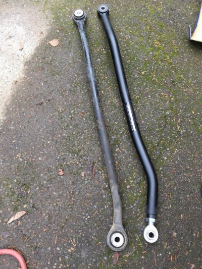

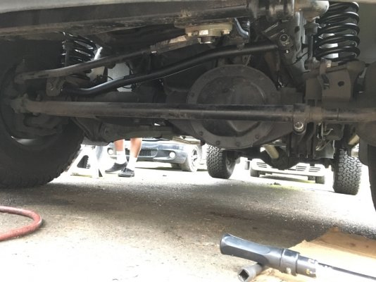

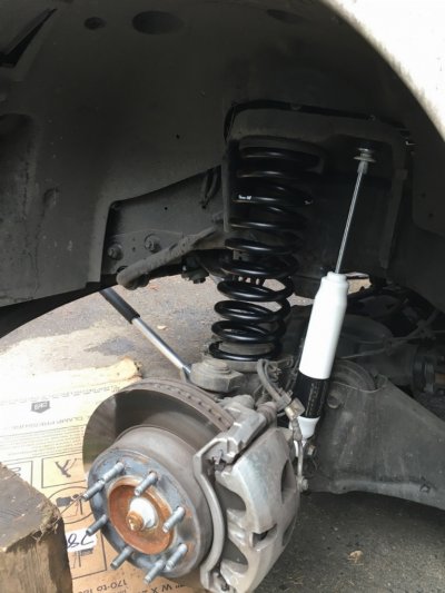

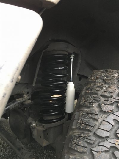

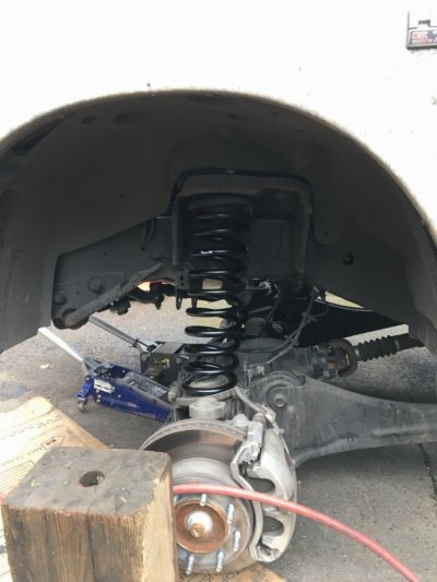

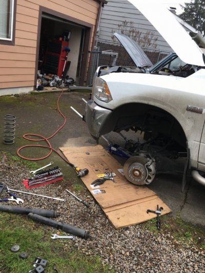

2" Thuren Hemi coils, Overland front shocks, and Adjustable track bar installed
Install went pretty smoothly, ride is much, MUCH better than a spacer and shock extensions. Measured 43.25" up front with the 2 1/2" spacer, measures 43.5" with the 2" coils. Sits exactly level with the rear at 43.5" here's all the pictures I promised!36659249626433e0bedd843f8095e029.jpg2e06fcc7f24ab8e11846f816df8ef01c.jpg4b83c420e9909f4c93c2b2c3d34b5f2b.jpge1a0b398fbbb5de82bee5be62eab7d48.jpgc714043d66b17443ec9f8ecee1f25e0f.jpg00521b3df26887db999bddf4527c75d7.jpg45cc8249aad874495d0004122e9ba273.jpg46d646cd50a59e85e8b4622f67f9593c.jpgf0f005f1dd6e638068f4927273aa1dfb.jpg
