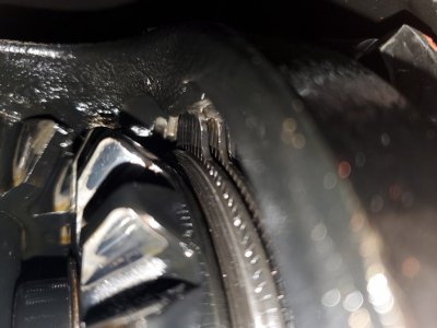

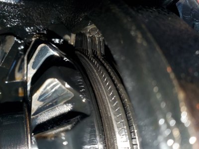

Hi everyone, I'm new to the site and this is my first post. I'm having some issues with my rear differential. The window sticker calls it an 'anti-spin' differential. I guess that means limited slip. I decided to change my diff oil this weekend and found one large piece of steel and a few other fragments stuck to the magnet at the bottom. I've never heard any abnormal noise from the rear diff, but this prompted me to do some further investigating. I noticed that there were multiple metal plates behind the bevel gears for each axle that had worn grooves into the surrounding metal. I couldn't see any broken ones but the metal obviously came from somewhere. I will post a link or some pictures. I'm hoping there are some 2nd gen savy people on here that can help me out. I love this truck! Thanks for your time

Originally from New Jersey but brought to Florida before i bought it a little over a year ago with 112k miles. It has 126k miles now. Im trying to get her back in shape.20191124_130146.jpg 20191124_125630.jpg 20191124_130027.jpg

Yup see it all the time with these,the clutchs are worn out.
Is it something to worry about? Or will it function just like a normal diff now. I have no problems going around corners and I haven't put any additive in it yet. Thanks for the replies guys

This has been a common issue with the Trak-Lok diff in the 9.25 Corporate Axle. The broken metal piece is one of the clutch retainers. It will still function like a limited slip for the most part but without the retainers in place the clutch discs do not have the same amount of holding power.
Thanks. That's a relief. Now all i have to worry about is my tranny rebuild

Here's the real problem though.
When the clutches get metal to metal, those metal particles start to travel through the bearings. Yes, some is caught in the magnet at the bottom of the housing but not all of it.
Eventually the metal particles find a weak spot, usually the pinion bearing. And they work on it until it squeals, then roars, then comes apart. If the noise was ignored, then the destruction can be catastrophic. The pinion will try to shove itself through the ring gear into the differential housing. Really not a question of if, but when.
You have time to properly repair the issue. Simply have the clutches and retainers replaced. It's cheaper than an aftermarket differential.
BTW, should the rear lock while the vehicle is moving, it will shove all the engine power back into the drivetrain. Ever see a blown up transmission sprag? I have.

I have to agree with Okiespaniel, it will destroy itself. Fix it now!

You think all I need is the retainera and clutch plates?
I have repaired too many to remember with new clutches and retainers. I would inspect the spider gears and the pinion mate shaft for uneven or irregular wear as well.
