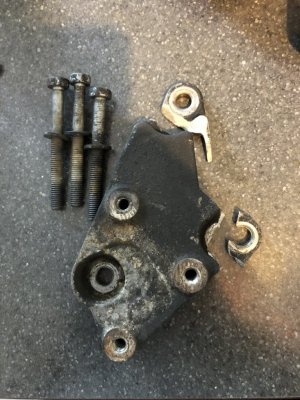

I have search the forum for help w/o luck.
I have a 2003 1500 with the 5.9(gas). Yesterday the bracket holding the power steering pump broke. Part is has been discontinued by dodge, parts stores don’t have it, tried 6 junk/salvage yards, and the only thing online that I can across is a similar looking bracket, but different part number, for the 96-98 Jeep Grand Cherokee’s with the 5.9. Part number is 53032725AB. Local dealership was no help.

Junkyard first. Dealer can't help you because it's a discontinued part (I mean, they haven't made that engine for 16yrs now...). Next would be finding someone who is parting an engine out, maybe even car-part.com.
pacofortacos
Apr 18, 2017
3,611
4,429
Well you could have it tig welded
OR
I have one but it has a broken bolt in it, you would have to drill the bolt out/worse case helicoil the one hole.
