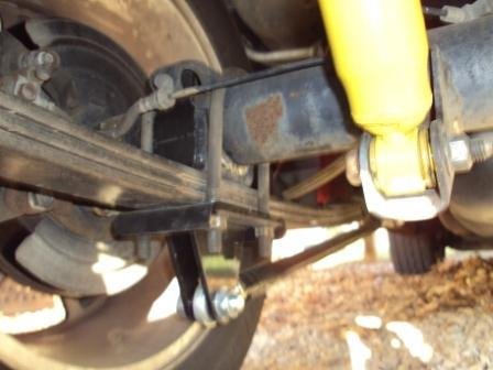

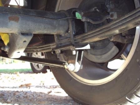

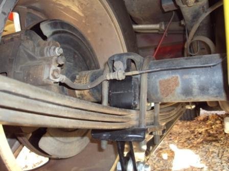

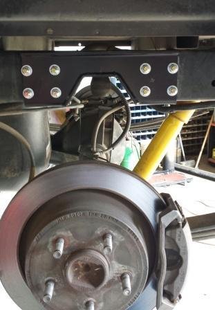

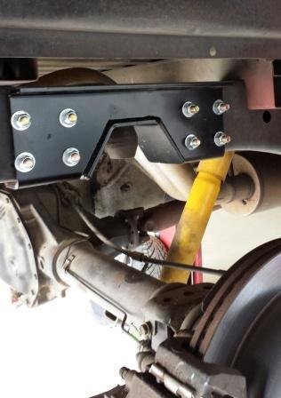

These are old photos when I first flipped my axle. I spot welded mine to keep the axle from turning under hard acceleration. Some folks do it and others do it after they fix the damaged from it turning.
Now, been running this configuration for a couple years totally without issue and a great ride.

How much drop did the axle flip give you? And what kind of bar is that that runs from the bottom of the leaf springs to the front hanger?
Sent from my SCH-I545 using Tapatalk
Redtruck-VA
Jun 29, 2010
5,864
985
Virginia
2003 & 1989 D250 RWD
Hemi-5.7, 5.9 12v & 24v diesel

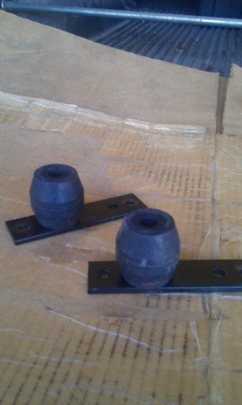

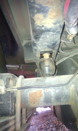

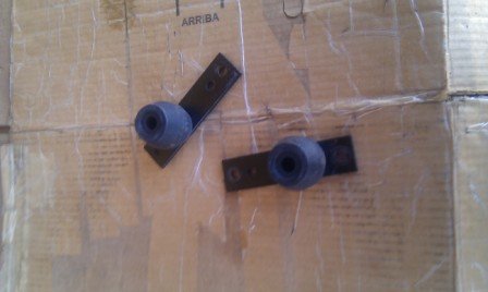

A flip is good for 5 or 6 inches depending which hole in the shackle you use. If the OEM shackle is used you are at 7 inches. The 5 or 6 inch drop can be tolerated with using Tembren rubber springs, I choose the 660# one's and they keep the chassis from hitting hard. They look like simple bumps but believe me they are a lot more than that.
