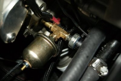

Ok I know there's going to be some that will help and some that will just be a jacka$$ but we have a 1957 Chevrolet BelAir that we have stuffed a 2004 Durango 5.7L hemi into. We had to have a oil pan built to fit the under carriage components therefore oil pan was off for some time, no oil in car for 8 months plus. Now we have pan on oil in pickup tube new gasket filled oil filter with oil plugged the two port holes on the passenger side of engine above oil filter fitted a T with sending unit and original sensor for computer on end of the T. We have tried pulling the sending off pulling the plugs to make the engine spin easier, spin engine backwards while having a line plumbed into where sending was located to suck oil into oil pump, thought was possible air locked, it didn't work. We tried loosening the oil filter cranking engine to see if oil was pumping no luck either. We tried two different oil sending units, two different oil pressure gauges, still no oil pressure. This engine was running and only has 12000 miles on it, and ideas need help, we have to pull all the suspension loose motor mounts loose jack engine up just to get the oil pan off, tired of doing this, and help would be greatly appreciated. I will add photos of what the T looks like and where we have it placed. Oh yeah and quite often I am a jacka$$ so if you have valuable info please post it.

I have a suspicion the T you have the sender unit in may be the issue. Have you tried putting the unit directly in the block without the T? Or pull a valve cover off and turn it over to see if oil is pumping up there?

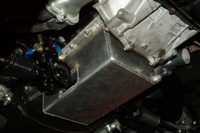

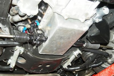

Heres a photo of the oil pan for the hemi/chevy bel air.

So, the linkage path is a full baffle inside the pan? Can oil pass under the linkage to fill the section with the oil pickup? How full of oil is that pan? Are you sure the oil fill line is higher than the linkage baffle? I'm thinking the pump is sucking half the pan dry and not refilling fast enough.
I'd have to suspect that pan design. You may want to consider a dry sump application here.

Ahh a bread box, reminds me of some of the pans we used on our chevy II's back in the day. Is the pick-up tube flexible ie possibly collapsing. Where is the actual pickup located in the pan? As stated any small leak will prevent oil from being picked up. Maybe an external oil return bolted to the outside of the pan? I'm thinking simply a air leak on the modified pickup.
