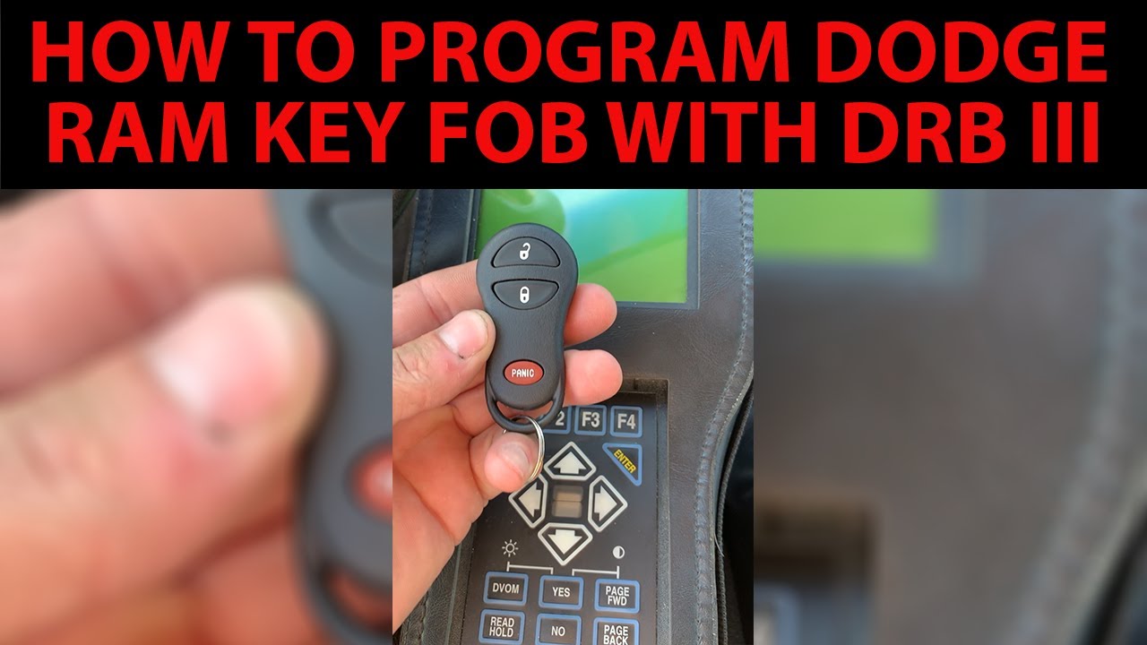

He has a 2004. Neither fob is correct. RKE = Remote Keyless Entry. Remote Proximity Keyless Entry is what you are referring to.
HemiLonestar
Navy Badge Coast Guard
Jun 1, 2012
6,815
4,690
MD
Just like the one in the video you linked. Problem with video #2 is that he is using a DRBIII and not too many people just happen to have one (they're not cheap).

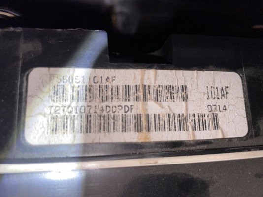

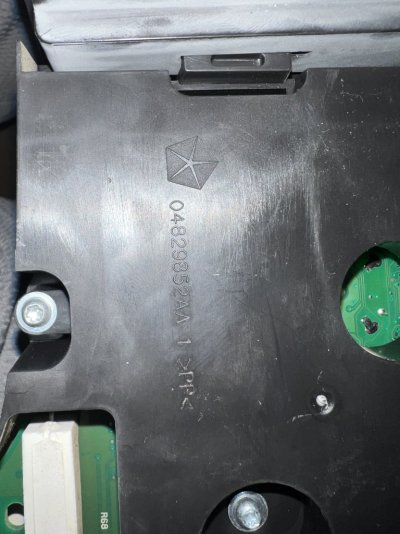

I need some help with something similar. My truck is a 2004 Rumble Bee so I know for a fact I'm supposed to have power locks. However my power locks haven’t worked since I got the truck. I recently have been looking into a new cluster because I thought mine was on the last leg of its life, this is when I came across the information that there is a cluster for trucks with AND without power locks. This newly found information has me questioning if I even have the correct cluster in my truck because when I got it there was one laying behind the seat with a crack in it so I tossed it out without thinking about it. I have my cluster out now preparing for a custom gauge face so I took pictures of all the different numbers around the cluster including the rke module and all the other numbers. I know nothing about this kind of **** so hopefully one of you veterans can help me with this conundrum I have. Here’s all the pictures of what WAS in the truck. Can you tell me if these were originally from the same truck somehow or do they not match whatsoever. I see a number on module that ends in AB and the cluster number I see ends in AF. Someone please shed some knowledge on this stuff to me and help me diagnose what the hell is wrong. Also even a blind man can see that the cluster itself is in way better shape than the rke module. So did this cluster in fact come out of somebodys work truck without power locks or what? IMG_4832.jpegIMG_4829.jpegIMG_4825.jpegIMG_7257.jpegIMG_4830.jpeg Thanks in advance
Daw14
Nov 29, 2017
3,434
5,491
South Florida
Those last two letters are just part number upgrades ,same part just a newer version. The
