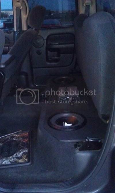

I have normal depth subs ill post a few pics when i get home

only pic i got of em :(
but these are jl audio 10 subs and they are full size and they POUND!!!! my buddy has rockford fosgate 10s shallow mount and they are mounted in a stealth box and mine KILLS his system.
