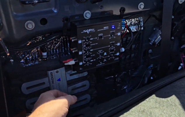

Of course the first thing to go was the sad excuse for a subwoofer. That plastic box and triple coil sub was very quickly removed and replaced with the same sub amp I've used for 20 years now (literally from daily driver to new daily driver, except the Jeep GC).
I did have to add a pre-amp with cross over to fine tune the signals from the factory signals to get the sub to sound right. But that part works great now.

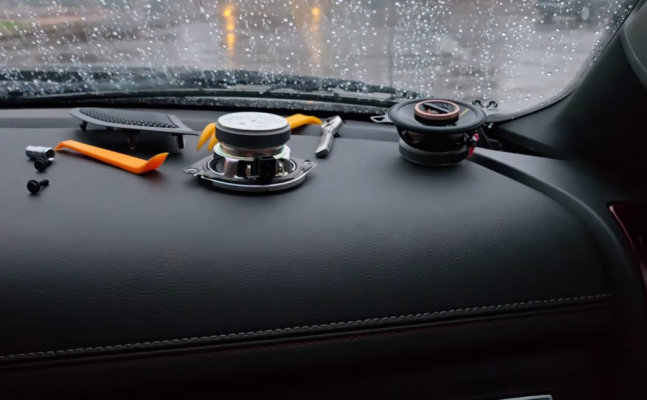

Well. I finally popped out those speakers in the front dash and tested them. No tweeters and no reproduction of any of the higher treble frequencies. It was as if Ram left out the highs in this system!
So, in went in a set of Infinite Reference 2 way component speakers.
Yes! Man that fixed the highs that was completely missing form this system.

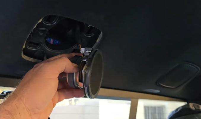

But then I replaced the same exact 3" speakers in the rear in the headliner.
Now, while the system is night and day BETTER than it was. I just keep noticing that I don't seem to be hearing the instruments and voicing from the rear as I expect from a somewhat high end system with "surround sound" etc etc.
I figure it is because those rear component speakers are still facing down and don't have the deflection to my ears like the ones up front do with the windshield.
But now this week, I use the fader to the back. Notice in deed those very same speakers don't seem to be delivering anything remotely like they do up front. So I hop in my back seat and am like "WTF is this?"
It seems that the system is delivering a very limited band of frequencies to those channels.
Like no deeper mids. And not much for highs but some. But like a very narrow bandwidth somewhere above the major vocal range and the highs. Sounds like to be honest. What is going on here???

I went through the same aggravation as you (24 Limited). Wife's 16 Jeep GC sounds great, but my 2014 Laramie with Alpine sounded even better.
I replaced dash speakers (all 3) two Infinity Reference in corners and a kicker in the middle (probably didn't do much). It was better. So I replaced door speakers with Infinity Reference as well (2-way in Front and 3-way in Rear). The change in the front didn't do much (all bass). However the rear door speakers will now overwhelm the front speakers. It also sounds a bit "tinny" at times - too much high freq - and the mid is not strong enough for me. Thinking I should have put 2-way in the rear doors.
On the doors - I had to reverse polarity on the speakers because of the Active Noise Cancellation (ANC).
I did nothing with headliner or sub.

After posting this I realized that the rear headliner speakers, which were the same 3" as the front dash, only have a narrow band thru them. Not full mids and highs. So that explains why the infinity speakers I replaced them with can't be heard from the front as a surround sound!
I noticed that while the front door speakers are lows only, the rear door speakers are where the full range mids and highs mainly come from.
So I may try finding a wiring diagram and take the rear headliner speakers and pair them up with the outputs for the rear doors.
That may be all that it takes.
My system sounds pretty dang good with the front infinity speakers and my aftermarket subwoofer and sub amp.
I am just missing that surround sound like I had in the Jeep QC.
If I can just get some of that back by rewiring those rear headliner speakers that would be great.
Although they fire down and have no glass to reflect off of like the front. So I won't know if they will work well until I try.
If they do not work well, I may relocate those to the corners into some enclosure or something.
