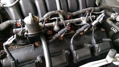

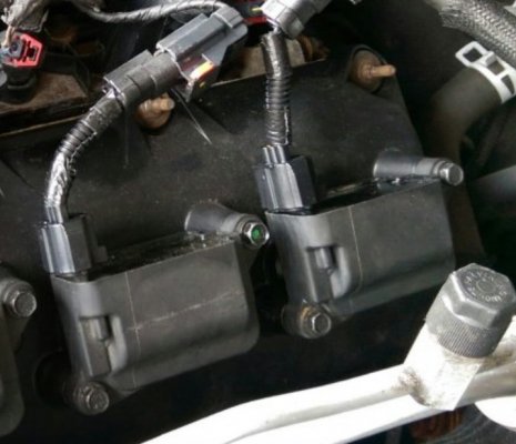

Another question the ram must use factory coils and ignition wires across only? Or can 2007 coils that eliminate the use of plug wires? I realize the ignition plug is different , but if theres away to have the cleaner look as well as a updated coil would be nice

Yes, unless you hack up your harness or get coil adapters like these, then you can use the later valve covers and coils:

Will this kit eliminate the need for the plug wires then, or am I missing something?
You're missing quite a bit, and apparently the pic didn't help lol. These allow you to use the 2006+ coil packs and their associated valve covers; it doesn't just get rid of the wires.

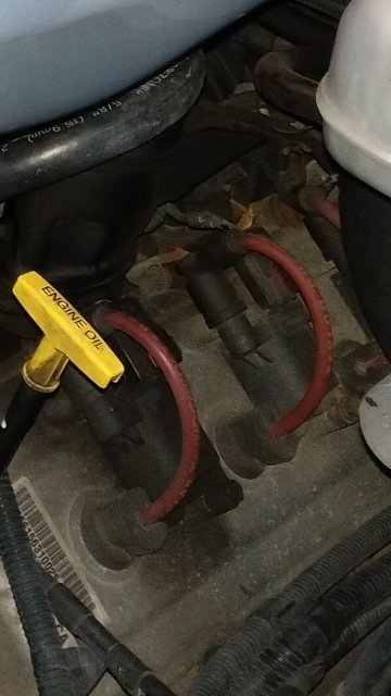

Thanks. I saw a kit once that got rid of the wires crossing over the engine and used wires that were shorter. Can’t remember for the life of me where. Without looking, I think it was for 03-05 HEMI and made them like the 06-08. I could just be pulling this crap out my ass, there’s that..... LOL
You're thinking of the Taylor shorties, they simplified things but still used the same coils. Like these:

Simplifies and cleans things up without having to hack up the harness (the plugs are different)
