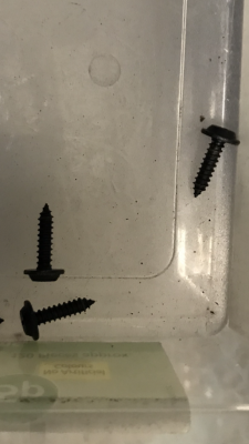

Hi after 2.5 years ive finally started putting my ram back together after re-spraying it.. I have a problem on the rear doors ( quad cab ) ive got 4 screws left for each of the back doors and I just cant see where they should go.. ive looked everywhere ! ( well apart from where the screws go that is ) im now wondering if they go somewhere near the back doors and I put the screws in with the rear door storage tubs so they wouldn't get lost and I would know where they went... I never thought it would end up taking me 2.5 years to get it painted.
the screws have a phillips type head and look the same as the ones that hold the speakers in... can anyone even take a guess ???

I think there are screws on the soft trim between the window and door, where the window rises out of the door? Or maybe the weatherstrip between the cab and door? There May be small phillips screws at the bottom of the interior panel as well to hold it on the door after you hook it on.
Just complete guesses without going out to look at my truck. Pictures of the screws might help if it wasn’t anything that I mentioned.

Have you put the door handles (interior) back on. There's a single screw for each of them that's kind of tucked in behind the handle.

I will try and post a photo. The screws are fairly long. I’ve put the doors back together and nothing seems to be missing. That’s why this is so weird.. as these four screws are left on each side.

i have solved the mystery !! the screws hold the rubber bit of trim on that goes between the inside of the front of the rear and seals the gap with the front door... I had attached the trim with some clips I found in my stores, which worked ok.. I pulled the clips out and tried the screws which fitted perfectly.. so thanks for the input !!
