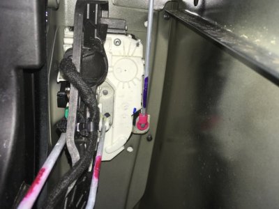

I had a similar issue where the door wouldn't lock. One link wasn't connected.
When I installed dynamat, I had to disconnect everything. Believe I forgot to connect one link. Doubt it slipped out because the clips hold the links tight.
Pic is the lock for driver's side rear.
