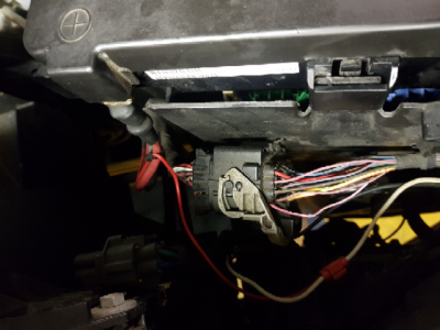

Thnaks WTM75 Problem resolved was a loose overcam connector. Went back through steps I had been doing and must have got knocked. Was checking all cam locks tried this one all works perfect .
Hope it helps anybody else who has a similar issue
