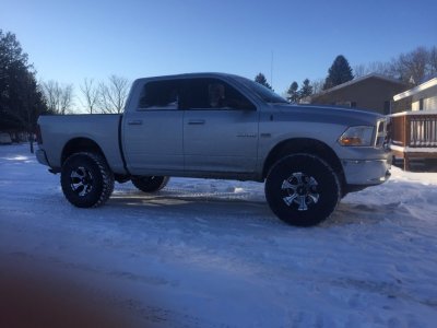

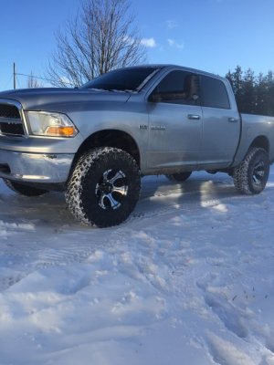

I have a 2010 ram 1500 that i recently put a 6 inch rcx lift in and finally put some new tires and wheels. Will post pictures and answer any questions anyone has. Turned out great and am very happy with the turn out!

What size tires are you running on the truck? Please post pics!

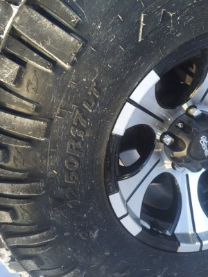

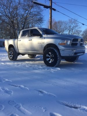

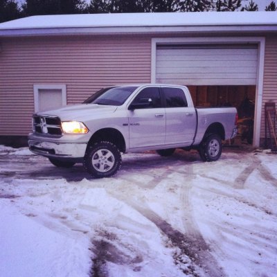

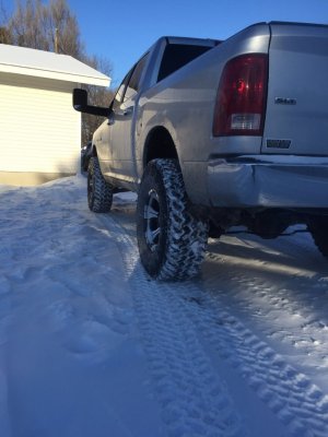

I am currently running Nitto Trail Grappler 37x12.5r17 that i just got yesterday! here are some of the photos!

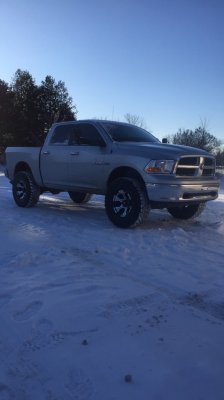

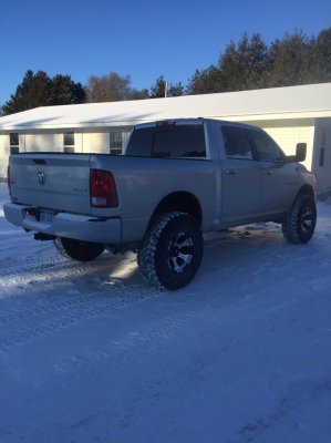

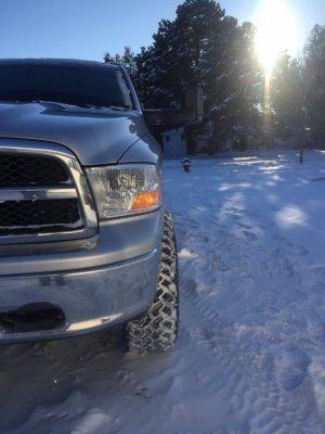

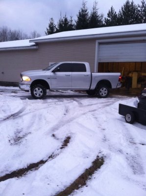

Some more photos, will get more when the weather is better and i can keep my truck clean!

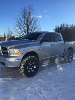

more

gpelleran
gpelleran
Jan 7, 2015
14
2010

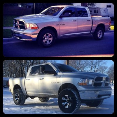

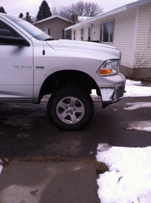

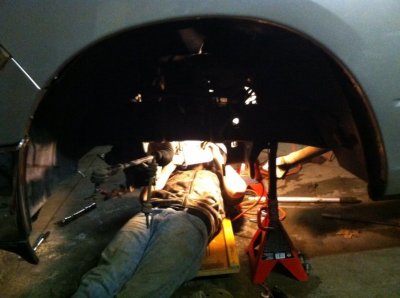

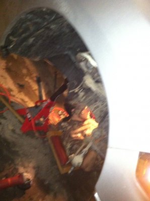

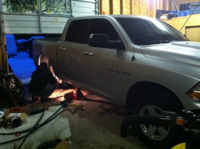

Before and after

how is the install? Is everything reversible ? Im thinking of buying this lift for my 14 but dont want to do any cutting and welding. I used to be ASE certified and have access to a fully equipped shop but dont want to take up a bay for more than the weekend
gpelleran
gpelleran
Jan 7, 2015
14
2010
Thanks, i definitely wanted to go for the more tire and less rim look..i was a bit nervous at first what the outcome was going to look like but i love it. it turned out great and am very satisfied. i definitely recommend rcx suspension lift all they're parts seem very will put together and durable. As for being reversible haha id say to an extent my lift required no welding but did require cutting of the front and rear cross member.
gpelleran
gpelleran
Jan 7, 2015
14
2010
The lift process really isn't too bad just takes some time and a lot of patience. Lol. I'd say it took about 12-13 hours of work for me and two buddies to get it done. I've read on some forums though it's taken less, about the same as me and even longer. So I suppose it really depends on quickly you are moving and how many problems you run into.

Thats the RCX 6" suspension lift? hmm. It looks lower for some reason, the 37s look stuffed. Reason why im asking is cause i have a Zone 6" lift and just trying to compare. I went with oversized 35s though. What kind of gears do you have? and also what kind of mileage you getting now with the 37s?
RamED
Nov 24, 2014
27
22
Vriginia
2009
I really wish they made a 36" 12.50 readily more available in popular tires/treads. Does anyone if there is a metric size 36" 12.50 or a little wider that is a popular tire (Nitto/Toyo/etc)??
gpelleran
gpelleran
Jan 7, 2015
14
2010
Here is my output on the looks of it sitting a little lower. Am i right? i have not a clue lol but i feel as if trucks that come with 20 inch rims sit higher stock then the trucks that come with 17 inch rims like mine for instance..am i right i don't know that is just a theory i have. Also, i see you're running bilsteins with your truck which would definitely change mine if i had the shock set up...my truck is two inches lower in the front then the rear..annoying. i play on buying the 5100's soon. i do think it doesn't look as high also just because it is stuffed now.
And to RamED i do know they make a 355x60r20 but I'm not sure if its very common and its like 14 inches wide I'm pretty sure lol but that comes out to about a 36 inch tire in metric.
gpelleran
gpelleran
Jan 7, 2015
14
2010
my gears are 3.92 I'm pretty sure too by the way and I'm not getting **** compared to what i used to for gas mileage...probably 10 maybe 11
draken
Mar 11, 2012
178
71
Vancouver, WA
Cummins
That makes sense, i have no idea about stock height for different rim sizes. You should definitely put some bilsteins up front to level her out, totally different look an looks great.
