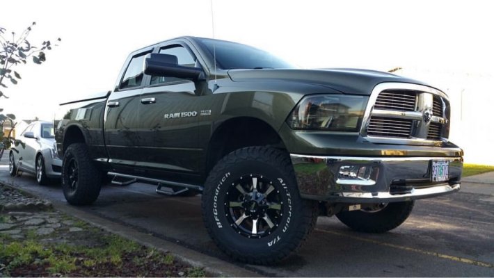

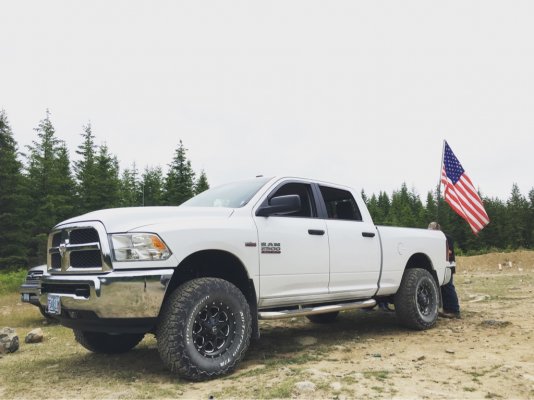

I have a 2015 2500 5.7 with 4.10s, leveled on 35s. Coming from a 2012 1500 5.7 with 3.55s, 5" lift on 35s, the truck pulls what I ask of it like a champ (4-11k lbs) f9b119d9660dc229af1abe64586db996.jpg1e011dfc8554b2cfcd9a29e80b936c9c.jpg
Your truck looks awesome!!!
