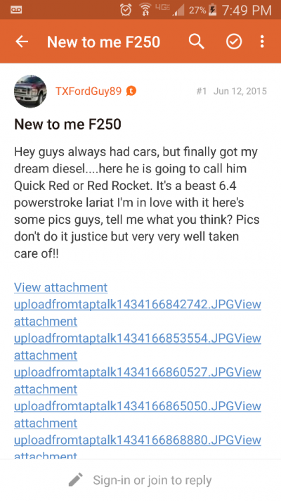

Your screen name is "CumminsTxBoy89". Asking about a hemi?
So then I click on you in Tapatalk...
Fordguy, duramaxguy, coloradoguy, cumminsguy....

So, what's the bit here?

Yeah cause again I would love to get Cummins hands down always loved how they performed but the price some ppl want is hard to swallow.
Yes I do have all these other profiles been doing research on all brands trying to find the best in which suits me and my needs.
