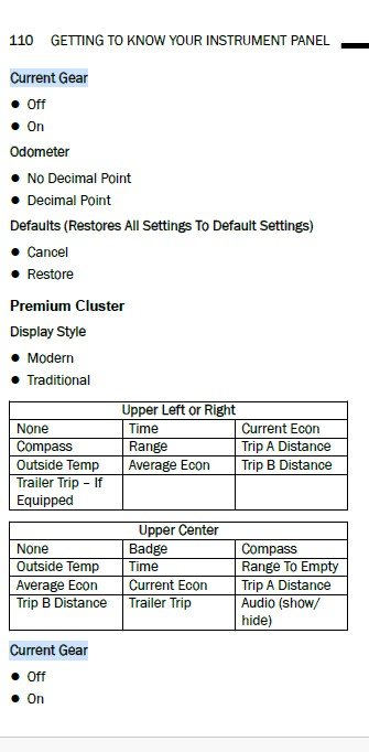

Ok, so that's what I was wondering with the ERS or gear limit buttons on the wheel. Is there a way to enable or "show" what gear the truck is in at all times? Like in my F150 within the tach area on the right hand side 10 through 1 was shown vertically in white. Whatever gear I was in showed up red.
Yes. In the settings you can make the current gear shown right next to the D.

And I don't think there is a setting on my truck to show the current gear next to the "D" while driving. If there is I cannot find it

There is, U gotta find it,. From 2025 Manual, "Settings".
That is controlled from buttons on steering wheel showing what DISPLAYED in EVIC..

turkeybird, thank you so much for providing that info. I found it within the settings menu. I guess I didn't look in that menu before this.
