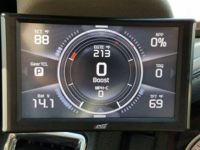

I used the Edge CTS2 unit as I like the configurable gauge package.

There is a lot to a delete & tune mod for these trucks. Here is my complete list which may help. They are all part of a total approach to improving performance, driveability, fuel mileage, transmission life & the exhaust tone.
Delete & Tune mods
Edge CTS-2 Insight monitor with Cummins unlock
13 – 17 EFI Live Dodge CSP4 tune package by PPEI / Kory Willis
13 – 17 EFI Live Dodge transmission tuning
Cummins tuning switch CSP4
EGR valve and cooler removal with block off plate
Throttle valve delete
Edge expandable EGT probe kit
Pillar pod mount for Edge CTS2
Transmission mods
BD Diesel 68RFE valve body plate kit
Mag Hytec deep transmission pan
ATS 68RFE transmission case support brace
Exhaust Upgrade
FloPro 4“ cat & DPF cannister delete pipe
4” – 6” black exhaust tip with rolled edge
Corsa 8004002 4” muffler – placed just downstream of down pipe
