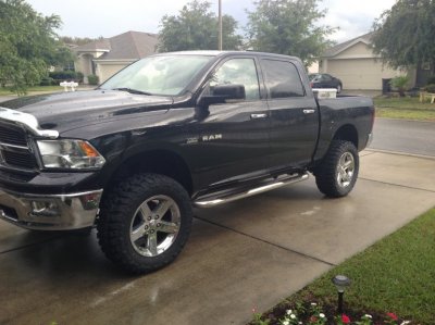

I put a Rough Country 2.5" leveling lift kit with a 3" Performance Accessories body lift. I got 35x12.5 tires on my factory rims but I had to use wheel spacers. I've heard people saying that when they put the spacers on the rear, that come with the Rough country kit, that it isn't level, but mine is. Both kits are very inexpensive and combined give you a pretty decent amount of lift.
