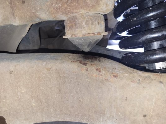

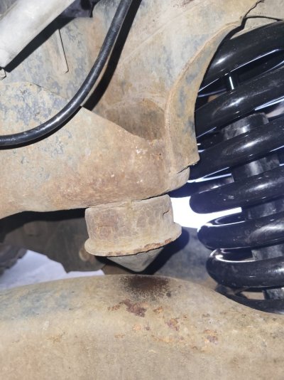

Hey Guys Ive replaced all ball joints, tie rods, sway bar links and shocks all the way around in my 03 single cab 2wd. It has always rode like ****. It rides so bad that i took off my 20s with 275 60 20 tires and put on some 17s i had with smaller tires just because i know the larger sidewalls make it ride nicer.
Anyway I noticed my coils are probably sagging as there is about an inch at most between the front bump stops and lca. I figure this has to be my rough ride problem.
I found some coils on ebay but I was curious how much room there should he when new between the lca and the bump stop?
The only other modification i have is 2" rear drop shackles. Any chance you think this would this contribute to the poor ride?
I know before i bought the truck that the previous owner replaced the rear axle himself. Im thinking there is a possibility maybe he didn't torque the leaf spring mounts correctly? Too much torque might not let springs move? I know when i put the lowering shackles in I didnt torqe them at first and they squeaked when moved. I torqued them to spec and they stopped squeaking but I never checked the front mounts for proper torque. I was just thinking about that last night.
Any advice here? Im probably just going to order the coils and if it still rides rough I guess ill take out the drop shackles next?

the front end of that one definetly looks clapped out

Right...I think i should order those coil springs. Now im wondering about the front height with the new springs. i wonder if it will be higher than the rear after i install new ones since i have 2" drop shackles.
I might end up putting stock shackles back on after new coils if the front ends up being higher than the rear.
Any advice on how to install them? Seems like it would be pretty dangerous. I might hire this one out unless its not as dangerous as I think it might be?

So i redid the driver side. Flipped it around. Finished passanger side too. It rides better but how much distance should be between the bump stop and the lower control arm?

I just looked again and the bump stops are the same distance that they were before the coil swap. MOTHER FU**** all that work for nothing1000013509.jpg1000013507.jpg1000013506.jpg

There isn't a spec height in the manual for 2wd, only 4wd.

Coming back to this thread. I put that 2wd away for winter and id really like it to ride nice this summer. I saw this guy on youtube put new bump stops on that are shorter. My theory is my ram is hitting the bump stops nearly every time it hits a bump. With shorter bumpstops id think it wont hit the stops with greater distance between? Would this mess up my handling at all?
Also look at this screenshot of his oem springs and bump stops and his truck had 150k on it at this time. Why is his distance so much more between the stops lca and my distance is less than half of that even with new springs?!

I would think that putting on shorter bump stops would simply make the front end dip more, possibly causing a worse ride than what you have now. Your springs look a lot more compressed just sitting than your friend's in the last picture. What springs did you use?

As far as day to day ride quality, I doubt you are hitting the bump stops constantly. A small seam in the concrete or a small transition would only require a small fraction of an inch of suspension articulation. Even if your bump stops are only an inch away from hitting, you would need to drive over something that is at least an inch tall to cause that contact. Definitely with pot holes, railroad tracks and steep driveways perhaps, but not just a normal flat road. That can change if your shocks are trash causing the tires to "bounce" up but even with knock offs I would hope that aren't that bad already.
The only way the front end would be dipping I think as recoil is referring to would be heavy braking or if you are porpoising really bad after hitting a bump. You may feel more of that lean forward which you may not like but I would rather have that than an impact. Even then you really shouldn't be hitting bump stops in those situations, bump stops aren't for when the truck comes down under load, they are for when the tires come up due to impact. Shorter bump stops may help but yours are so small from factory I would not expect any significant change.
My coil sprung ram 2500 rides significantly better over bumps than my torsion bar sierra 1500, especially large bumps/impacts. I think a large part of that is the longer wheel base but either way I think the ram wins out. Not to say that one ram to another your coil should be riding better than the torsion bar truck, but no I don't think there is any inherent benefit of torsion bars that I would expect it to be the smoother ride.
