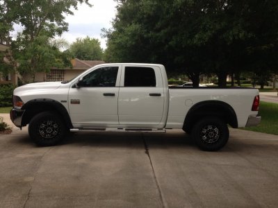

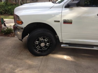

I just put some 18 inch vision rage rims with 285/65/r18(32" tall) michelin all terrains on mine. They clear by less than an inch at full turn but completely clear. I really like them but I did lose about 1.5 to 2 mpg's from the stock 245/75/r17s. I also put some lund flares on it. Mine is also a 2012 2500 crew cab 4x4. Love it so far.
