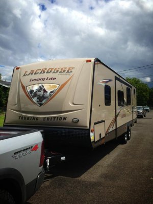

we have a 29ft bunk house prime time lacrosse all electric everything so pretty decently heavy.
our dry sticker weight was in the range of 6700 lbs. but factor in i have the 3.92 gears and the complete factory tow package.
I am in the process of adding airlift airbags.

wow, that lacrosse is a good bit heavier than the Jayco I was looking at...you are at 6650 dry weight and 778 dry hitch weight...at least 1k more lbs trailer wise and 200lbs or so more tongue weight...I have tow package, etc on my Laramie (3.55), but that really doesnt matter...8450 vs 10k gross trailer weight (max)..the issue is payload...at least that is what I am getting told on camper forums. Nearly every one has said it would be at my trucks limits, and very likely a good bit over the limits (payload that is). Seems almost all half ton trucks will hit payload issues long before getting close to the max trailer tow lbs. Have you by chance went to a Cat scale to see your actual weights on each axle and what the trailer actually weighs?
How is it towing for you? that model is almost exactly like the Jayco model I am looking at...same layout everywhere. That is a nice rig you got there!
i had myself the wife my mother and our son in the truck along with probably 150lbs of wood in bed of truck.
The trailer has something special with the wheels being spaced farther apart so they say it tows better, the only thing i noticed was it was pretty heavy and for the truck saying 10k towing i doubt your gonna be going up any hills at or close to the speed limit. i burned up almost a half tank on the trip and our campsite was 45 min away with one stop on the way home. id say we averaged close to 8 or 9. the trailer would want to pull the vehicle towards vehicles that passed and we didnt have any side winds when we towed due to the weather just lots of rain but not windy.
On the freeway was nothing just fine. it was in town turning etc that you would have to swing wide etc.
Keep in mind i have the smaller cab then you and i didnt have tow mirrors so i could barely see around trailer.
