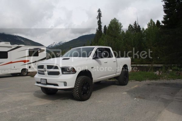

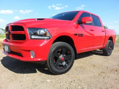

i have a 2013 ram 1500 2013. its 4x4. i see alot of bad information about lifting a AWD model. this might sound dumb but is that only if its always AWD and you cant choose to put it in 2X4 or 4X4 or AWD. becouse mine i can choose 2x4, awd, 4x4 high and low. does that mean i shouldnt lift mine?

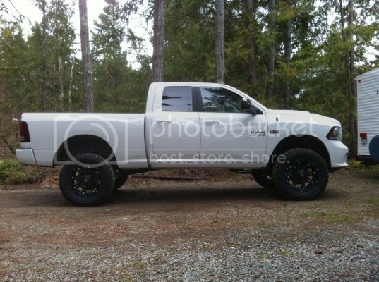

If you have a 4wd mode selection you're fine. Yours is the same as mine, I have a 6" lift, 2.1" Bilsteins and a body lift. It's not recommended on AWD vehicles because of the changes to the front driveline angles.

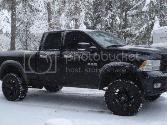

I have the 6" RCX and had to use Bilstein struts set at 2.1 to level it. Same as my 2011 and also had to use Bilsteins to level my '09 with a ProComp 6"
