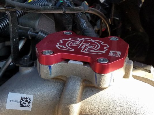

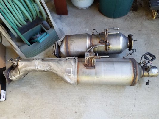

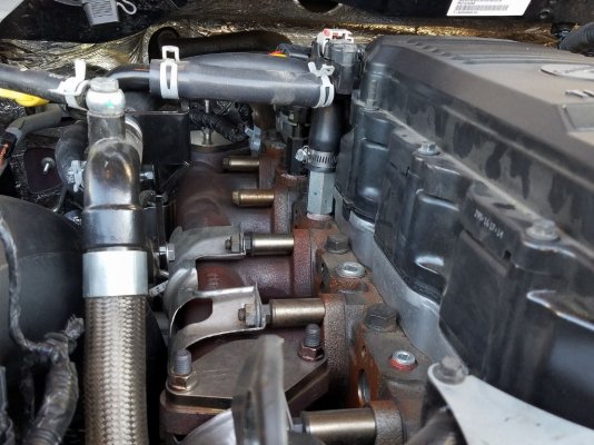

There isn't a "kit" per se but basically a full delete encompasses removing the two cannisters under the truck, draining the DEF fluid, removing the EGR, throttle valve and some other bits plus tuning the truck to, at a minimum, deal with any codes that will pop up.
Here's my list of what was done:
Delete & Tune mods

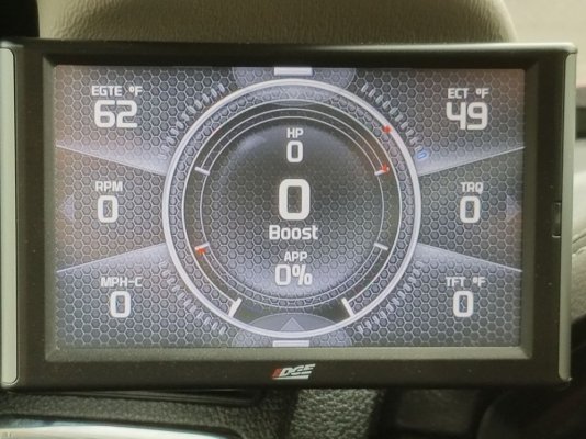

  • Edge CTS-2 Insight monitor with Cummins unlock
  • 13 – 17 EFI Live Dodge CSP4 tune package by PPEI / Kory Willis
  • 13 – 17 EFI Live Dodge transmission tuning
  • Cummins tuning switch CSP4
  • EGR valve and cooler removal with block off plate
  • Throttle valve delete
  • Edge expandable EGT probe kit and install
  • Pillar pod mount for Edge CTS2

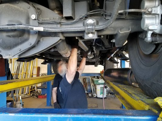

So when you remove the two cannisters underneath the truck you have to make up that length in pipe. The most common result is a straight piped exhaust. I ran it like that for a few months and got really tired of getting beat up by the sonics of that system. If I drove for more than an hour I'd start to get a headache. So in addition to the standard exhaust delete pipes being installed, I also put in a muffler.
Exhaust Upgrade
  • FloPro 4“ cat & DPF cannister delete pipe
  • 4” – 6” black exhaust tip with rolled edge
  • Corsa 8004002 4” muffler – placed just downstream of down pipe
