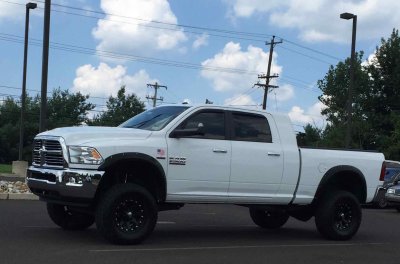

Running a 5" RCX with 35's (3.73 gears) on my 2014 Mega. Mine is a daily driver and have 20k trouble free miles on the lift so far.
IMO 37's would work best with 4.56 or 4.88's. ImageUploadedByTapatalk1459816402.554689.jpg
Since that pic I've added Nfab wheel to wheel 3 steps and a black diamond plate tool box.
