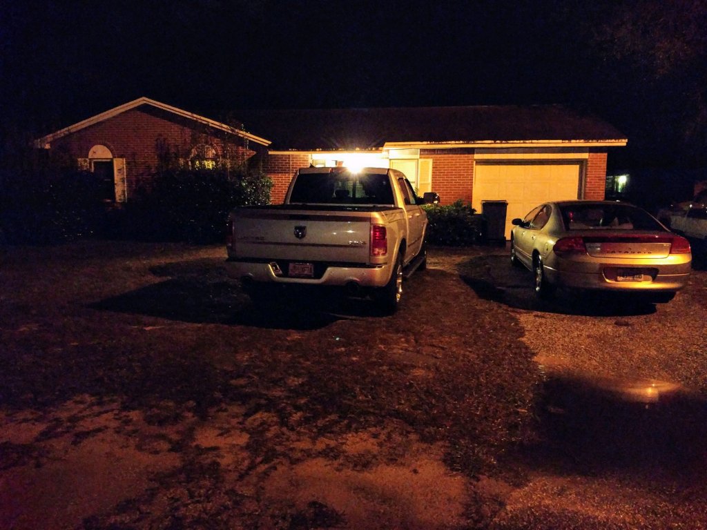

Just for the hell of it here is a picture I snapped when we pulled up to the techs house to take my truck back to the dealer.
