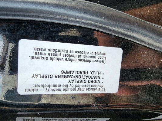

1. The back up camera for the truck was never installed but it says on the side of the driver door that it is available and ready for hook up.

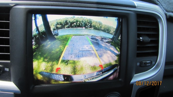

there are 2 different cameras,
one had no guidance lines, the other one is so much better
when you turn your front wheels, the guidance lines show your turn radius & how close a wall or tree is, by color coding

That seems like a good way to get it installed. but i have a 8.4 screen, on the side of the door it says its GPS and camera ready? ive looked up details by vin and they are saying that its all camera ready i just dont have the door handle to do it but i also havent opened it up to see if the cabling is there for the install. im sorry if im asking so much or if im not making a lot of sense. this is the newest/nicest vehicle i currently own to date and just wanna have some nicer features.

so your 2014 Ram does not have a Tailgate Handle camera, is what you are saying ?
The tailgate camera for yours also fits 2013 - 2018 Ram tailgate handles, it likely fits other years, but the sellers like to stay safe with the fitments
It also works with these radios, RA2 5" , RA3 8.4" , RA4 8.4" Navigation
The question that i would have, would CAMERA READY mean that the Radio is Programmed for the camera to work
& the wiring & camera needs to be installed
or
the wiring is installed, but not the tailgate handle & camera
2 places to check are on the tailgate, there is an Inspection Cover, look for a unattached wiring pigtail
Or
In back of the license plate, there is a unattached wiring pigtail

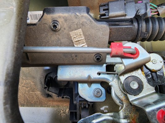

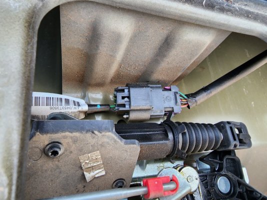

So this is what i have currently found on my 2014 Ram 1500 Big Horn 4x2 addition. any ideas?

just watch the video that i posted in reply #5
he goes step by step, watch each connection he makes, so you will know what you are missing
