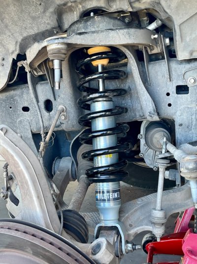

Replaced the front struts in the 4x4 ram 1500 with 115k miles. Original strut was starting to leak. I had the 3rd setting on the 6112 Bilsteins which gives a .8" lift. So far, the ride, steering, handling are very similar to the stock units. Maybe just a tad firmer over the bumps. Two hours and both struts are installed.

They look good! Took me the better part of a day to do my 5100’s.
