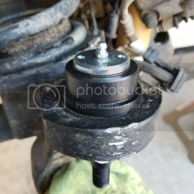

I've used moogs on mine at ~60k and ~120k, have had good luck with them with the bigger tires adding wear. I have heard a lot of good things about EMF, but I know they'll be harder on the wallet.

They are rebuildable if needed... so after 2 moog bjs the price comes close
